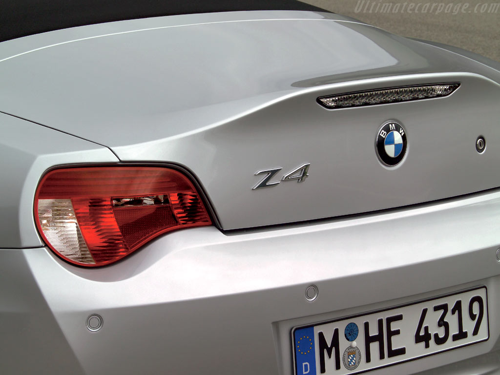

I have a 2003 BMW z4 and I want to change my taillights with the ones from the '07 models.
http://www.ultimatecarpage.com/images/large/2558-5.jpg
Does anyone know if they will fit '03 cars ?

To do the swap you'll also need to fit the rear bumper and light control model from a facelift Z
