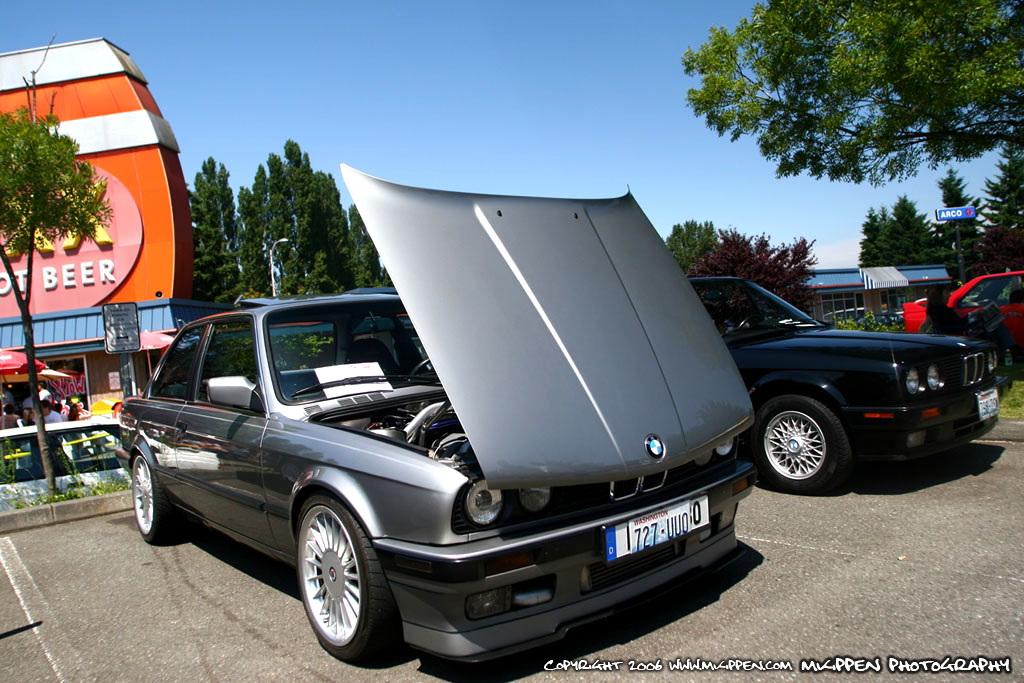

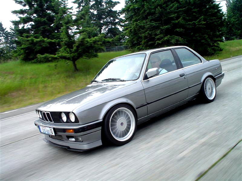

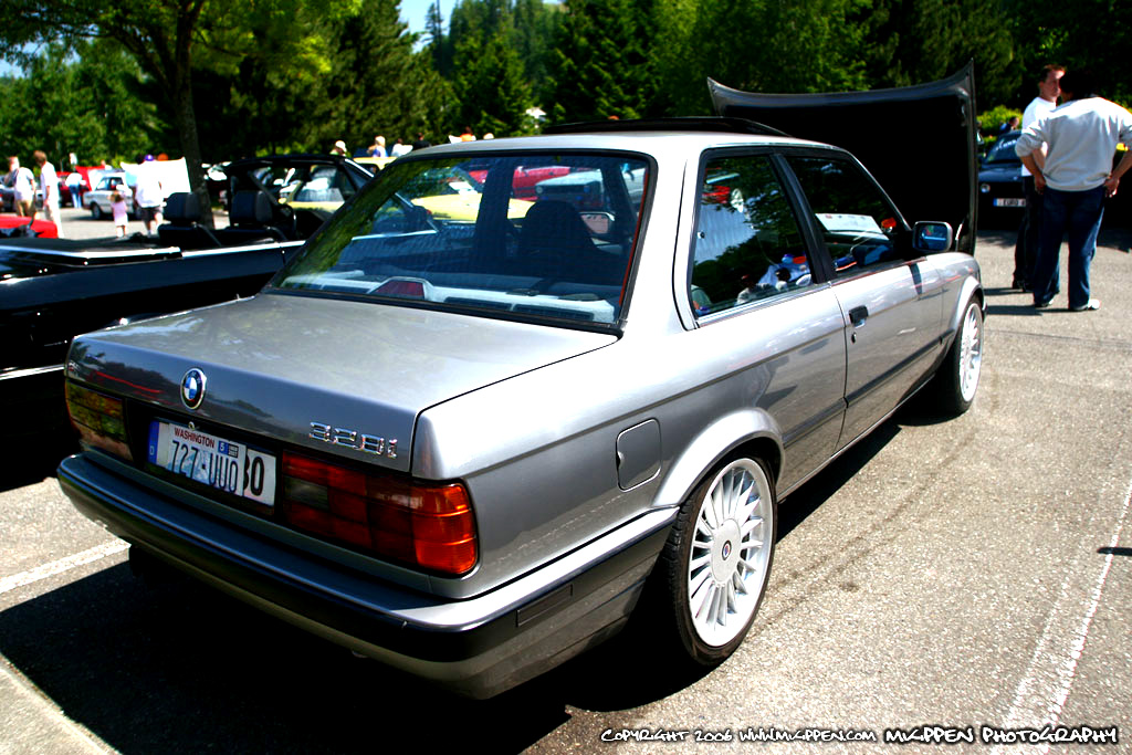

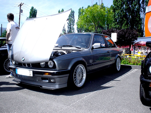

Here's a compilation of some good shots of my car going to, or at the e30 picnic. Pics taken by Mike Kippen, Chris Cramer, Ben (bendashdash), Josh (eurospeed) and I think James (Jrhaile), possibly another, thanks guys! Enjoy.

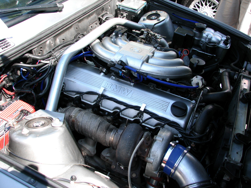

Currently running 16psi, 307whp and 353wtq on a dyno dynamics dyno (conservatve). More power in the next week or so, my ignition system is getting some changes.
questions/comments welcome.

wow very nice car. what internals are you using? tuning? did you do it yourself?
Old 06-22-2006, 03:36 PM
E30TRBO
Location: Olympia/Pullman(WSU), WA
Rides:1989 BMW 328i
Posts: 544
matt325is is a New Registered Member
Thanks guys.
0-60mph is in the mid-low 5 seconds.
Internals are: 524td crankshaft (forged), stock m20i rods (forged), ross racing low comp pistons, MLS head gasket, metric blue 12.9 grade head bolts, some head porting, but not much, stock cam. All rebuilding, fabrication and tuning has been done by myself. Engine management is Megasquirt, and controls fuel, spark, boost control, and fans. Its been quite the project, and I'm happy its finally kinda where I want it to be.

How does your MegaBoost setup work? One of my Volvo friends, who has a well-running Squirt'n'Spark setup, melted some pistons last summer with MegaBoost. It let his boost limit go from 17psi to ~30psi... Oops.
Oh, and your car looks great too :heart: Boosted e30!
