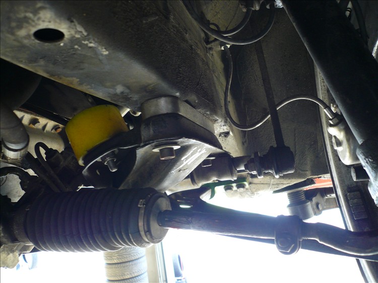

the engine is from 92 M5 Touring,, 3.8 L gearbox 5 speed E34 M5 brakebooster + mastecylinder ((25 mm)) VERY GOOD brakes imo
300mm.de engine mounts, + selfmade 20 mm alu-adapter to lower the engine subframe,,

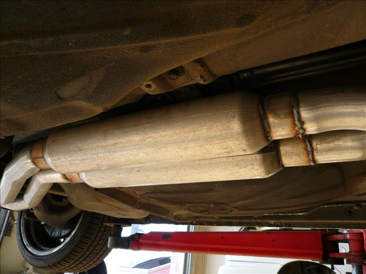

#) exhaust
#) more exhaust

What you MUST do ,, to get the engine running well and so on
1) lower the subframe... MUST (( dont start to remix the oilpan ,, the engine must go down anyway because you can NOT close the bonnet otherwise
2) www.300mm.de - Bremsanlagen und Motorhalter fr BMW E30 engine mounts,,,, again ,,stop trying to do this by your self,, it doesnt cost so much ,, but ,, it is possible that you have to make som fine adjustment on the mounts because of the headers,, take something away with a cutter,,
3) BRAKEBOOSTER,,, try ix or e34 M5,, you must redrill new holes and move the booster 15 mm to the left,, you can also use VW or hydralic or whatever
but if you prefer oem BMW this is the easy way
