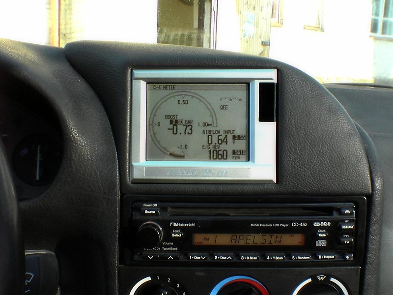

the basic unit itself is not enough just to handle for me, since it only controls the air and fuel mixture. but greddy sells a number of plug ins and sensors that allow you to control ignition timing, and also a pressure sensor so we can actually get rid of the Air flow sensor. It's not inexpensive if you buy everything available. Still runs around $1,000.
